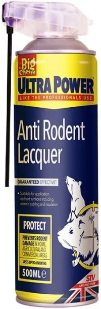

I've been having the same problem with hungry vermin. My local garage suggested this:
Just spray it on the edible parts and wires of your van.
