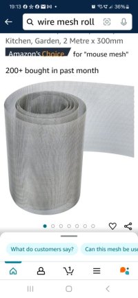

The first thing that comes to mind was wrap it up in steel mesh?.
You know what that'd be rad. I was thinking about some chicken wire but it's too much hassle to cut. Wonder if I could cut this and yeh simply ziptie to a few points.
I also thought about metal cable braiding but couldnt find any to suit, and this will work jut as well.
Means if anyone needs to work on van underneath is easy to get it off. Nice one!
Should be able to cut that stuff with kitchen scissors.(The mesh)
.. metal cable ties are tuffer. I use wire cutters to turn snips at work...
Yeh I’ll have a check on suitable temperatures as well just to double check it’d be okay butted up to exhaust
It's stainless steel... Exhaust should be no probs.
Says 800degc in the waffle.....
