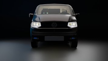

Hey folks, I've finally spent a solid day sorting out this model. It involved a lot of faff.
This took me hours in Blender, as I was learning a few things as I went along. However, this 3D model in blender is a good enough model to visualise and model your conversion.
Please do share with the community what you do, or if you improve on it.
STEPS TAKEN
  1. Finding a CAD model of a transporter - found on here.
  2. Converting the CAD model using FREECAD to a Blender suitable format
  3. Fixing issues in Blender
  4. Fixing materials
  5. Adding cameras / lights
  6. Deleting a tonne of objects and materials
  7. Setting up studio lighting
  8. Adding materials
KNOWN ISSUES
  • Duplicates still exist
  • Project structure could improve somewhat
  • Best practices have NOT been followed
  • This is NOT to scale
RENDERS
BLENDER 3D MODEL
VWT6 Final

Looking forward to seeing it! I know it has issues but it's the best model I've managed to find and convert for free. It's good enough to sketch out ideas with at the very least ☺
