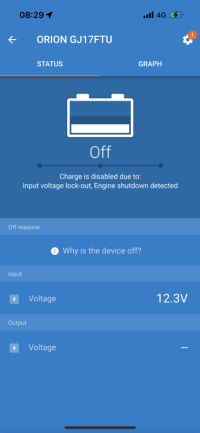

The Victron Orion TR Smart is your DC-DC charger, that's really your most critical one as it's what charges you LB from the van when you are driving. With modern engines basic split charge relays don't work well so DC-DC chargers are required. Think of it as a smart charger powered by the vans 12v.

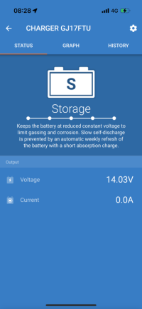

The Victron Smart Charger is likely one of the IP22 range, possibly IP67, this is a good quality 240v to 12v smart charger and will be running off your EHU.

Given you have a Victron mains charger you will want to have any built in charger off in the EC155 - the Victron will do a much much better job.
