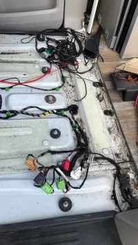

I’m going to start by taking everything up not only to clean, and understand a bit more about all the electric wiring underneath - but what else should I do, should I sound deaden while I’m here, the thick rubber flooring is worn down and has holes in places too - recommendations on changing that?
Recommendation on how best to tidy all these pig tails up ? Can I simplify it ? Do I need three pig tails looking for ignition/switch live ?
Orange wire look like it goes under drivers seat, another is for a dash cam, another is for main stereo video feed.
Ok, I’ve taken the rubber mat out, and made a start on cleaning it but there looks to be pockets of rust around the floor, and as the section under the pedals had warn out, water’s obviously got in and there’s a section of rust / ingrained dirt there. Any recommendations for treating that?

Part one of the floor clean up and upgrade is complete…
I had to sand back the rust under the drivers feet, caused by that rip/tear in the rubber matting, I’ve then spray painted it with Hammeright, clean it all up, Prep sprays it too, and have layer the Dodo Deadn (4.5mm) matting..
