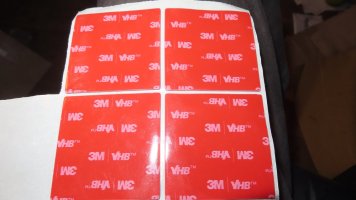

I use acetone to clean - I have found that alcohol will leave a trace on the glass, then fix with 3M VHB pads. Even then they have let go occasionally in extreme heat.
Tried Gorilla stuff but this failed, likewise with various other products.

Thank you guys! @oldiebut goodie the VHB pad seems to have worked a treat!!! The best yet anyway! It’s been up 2 months now and doesn’t seem to have budged!
