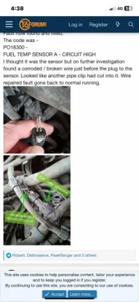

I’ve had my coil light come on the dash and reading up on site experience it seems it’s the sensor that’s at fault, my dad put a code reader on and it detected the same fault code as detailed here in other posts, I’ve replaced the sensor from VW put didn’t resolve the fault, looking at the cable it does have a small kink in the wires going into the plug housing.
