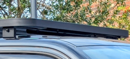

The wind deflector is this bit at the front on the underside, you can just see it in this pic
I think the biggest difference between the flat dog rack and the front runner is the flat dog main rack frame is fully welded rather than bolted together. That's why they offer free fitting! It took them less than 40 minutes to fit mine, they're probably done hundreds! It's made in the UK too at their HQ in lincolnshire.
