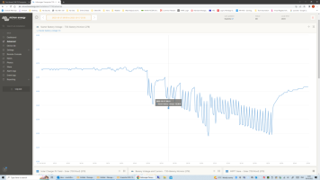

After a bit of googling it seems that the Garmin Parking Cable is supposed to be set to cut power at 11.7 volts however for me this seemed to cut at 12.2 volts which my van often dips under even when driving.
By leaving my starter battery on charge for an extended period, with the dash cam alive, in parking mode, I was at least able to prove my theory that the issue rested with a volt drop problem.
So, this morning I have gotten rid of the permanent power feed from Fuse 33 in the fuse holder and installed a new power feed from my leisure battery to the permanent live of the Garmin parking cable (Yellow wire) and now all seems well with no drain at all on my starter battery unless the ignition is on.
This whole episode of faffing about, was not helped by my Ablemail AMT12-2 maintaining my battery voltage. I therefore kind of ruled out voltage as being the problem. With such a tiny trickle charge, spikes of low voltage still momentarily occur, which must be related to vehicle control units when locking/unlocking or "We Connect" checking to the status of the vehicle from time to time. Whenever I tested during this faff it was always well over 12.3 volts.)
