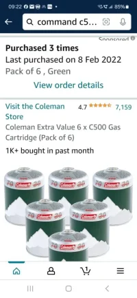

I am almost out of Jetboil gas and was wondering if I could use the same Coleman c500 canisters I have for my cadac
The Jetboil can says it's an 'isobutane/propane' mix whereas the Coleman is a 'butane/propane' mix
My uneducated guess is that the isobutane burns more intensely than boring old butane, hence giving the Jetboil the speedy boiling capability, and so using the Coleman with the Jetboil will be not great
Anyone confirm one way or t'other? Much obliged
I've used any old c500 in any of my cadac / jetboil.
All work fine, it just as you say different mix for lower temps.
