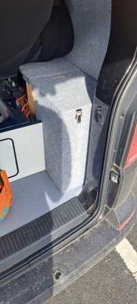

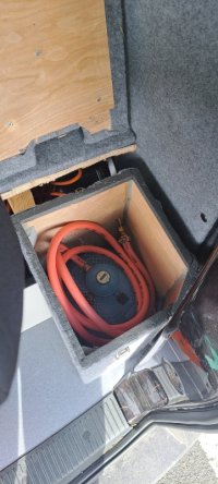

Hi, I DIY'd a bench alongside the bed, with plywood 'locker' at the rear. It's top entry, with clip down lid. Fairly well sealed, with vent through the floor. Copper pipe running through the bench to the stove. There's room under the bench for water tank and some storage. I'll try to add pics later.
OK, please excuse the mess and dodgy DIY skills, but hopefully these will show the basics20230305_111249.jpg20230305_111207.jpg20230305_111108.jpg20230305_111047.jpg
thanks, that does the job and your diy skills are better than mine. My kitchen is the full length of the van, it's a standard evo design slim so at least I wouldn't have to make a bench. I'm just trying to figure out if it's best at the back like yours of maybe even under the rib bed.
