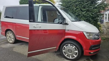

Then sorted out the passenger side electric sliding door that changed its mind about closing a few times. That was a case of replacing the bottom roller assembly. Quick and easy job with the right tools. (Star bits) the nylon wheel was completely missing, so metal on metal....

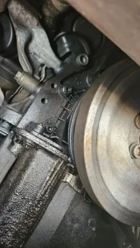

In doing so though I did see some oil on the engine near whay I think is the crank case seal.... have wiped it and will keep a close eye.

Jobs so far have consisted of the passenger side electric sliding door. It was refusing to close at times after we got it home. This was a quick and easy job replacing the bottom roller. (Nylon wheel on the old one had vanished so it was just metal on metal, ouch)

In doing so, I did notice some oil misting under/around what I think is the crank case seal, so have given that a wipe and will keep an eye on it.
