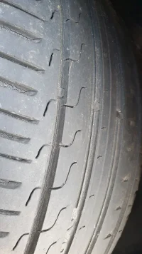

Just jet washing the van this morning and noticed a slight crack on one of the front tyres (see photo).
Checked the other tyres and all have evidence of the same happening in the same place on the tyre.
Is this a known problem with Goodyears ?
They’ve only done 16 k miles, fitted by the dealer in March’21. Loads of tread left on the rears, just under 4mm in front. Pressures all fine
Tyres are 4.5 years old.
I’ve emailed Goodyear, but they are coming off pronto. I had a mate take a look and he agreed with me. They look like how old tyres degrade according to him

Good year just rang me.
The tyres are safe apparently. This is something called chimneying where the earthing mechanism of the tyre is bubbling up.

I have the vector 4 as winter tyres and not seen any cracking but I know Michelin tyres suffer terribly bad for cracking and they even have a section on their website for it as it's cosmetic and not a safety issue so sounds just the same.
Im booked in on Thursday to get all the tyres replaced. There is no way this is 'just cosmetic'
I also rang the VW dealer who supplied them (they chose the make and model, not me). Wrexham VW van centre; they refused to help with the Warranty process, even though they supplied them; wouldnt even look at the tyres. Absolutely shocking.

The faint line is nothing too worry about all tyres have a strip of natural rubber in the tread to allow static electric to dissipate
