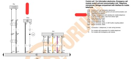

Hi all, looking for a little help retrofitting the gsm module to my t6
Need help with the wiring in, so far I have
red/blue to fuse c18
Brown to earth point
So need help with yellow/red and yellow/blue
Any help is appreciated thanks
