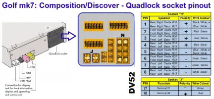

No worries will dig you out a connection diagram for the rear of stereo prob be tomorrow
Perfect thanks, I'm guessing I can just use the small metal cable connectors that side and clip into the OEM connector?
Are they called repair wires?
Yes they will fit, you can buy the plugs on there own to go straight onto speaker cable or you could use those but they are a bit expensive for what they are, repair wires are intended for fixing loom cabling or patching into fusebox as they use the same connectors on the small fuses
Pauly, are you able to post the connection diagram as I'm seeing my brother tomorrow and it would be nice to get his speakers working.
I've found a couple on the googleweb but I'm don't want to risk it being wrong.
Thanks again
I used this one :thumbsup:
The underside of the connector block has corresponding numbers.
