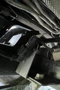

This plug has to be unplugged and it’s mounting plate released and moved to side to give little bit more room.
