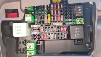

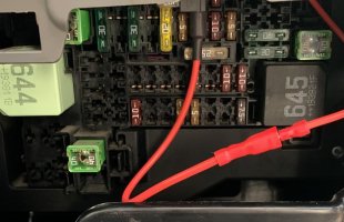

4th attempt - as I want to use Parking Mode - it has to have a permanent connection. So from looking at my fuse box, I may be able to use fuse 24 - Interior Monitor Modules 1 & 2, Alarm Horn.
I think I have found success.

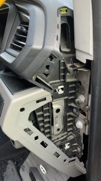

From my reading on this Forum I knew the side panel would pull off, and it came away with some gentle persuasion and no swearing or breakages.
Not only did that make the earth connection easier, it also enables better wire hiding possible.
I was initially thinking of going from passenger side, behind glove box etc, but no need - I can just go from the camera, over the driver's side and down the A pillar.
