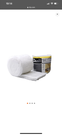

Has anyone used Wickes thermawrap or B&Q’s recycled plastic insulation?
I used the B&Q stuff for the sides and tailgate which is 60mm but was too thick for the roof, I had to buy some 30mm thick same stuff off the Internet.
Just used the B&Q insulation, 100mm , worked a treat in doors and rear quarters. Too thick for roof.

By coincidence I took a photo just now to demonstrate why even just the Diall recycled plastic bottle insulation is better than nothing (we fitted as a temporary measure this season). We've not sound deadened the walls so this is just insulation loosely held in by the factory panels

I used both, Diall for internal insulation (on top of sound deadening and thermoliner), and the Thermowrap for a DIY pop top cover. I wouldn't use the Thermowrap inside.
