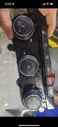

I’m trying to understand what I would need to do to connect my heated seats up in the van. Ideally as per OEM rather than seat base switches.
I found a panel but it has the ‘off’ switch on it also, is this an issue?
You need a linbus based heated seat module as well + the loom of course. The module is newer type so only ones dedicated to T6.1 would work not earlier ones like in T6 or other VW models that use it. What part number is the panel you found?
