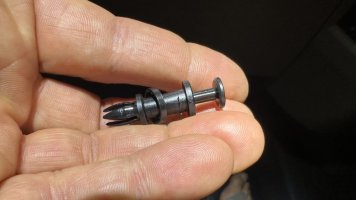

I finally got around to fixing the supports for our broken heater control
those plastic stand-off spacers are a &*^%$#@! joke!
for the sake of the next person, I took some photos to show that I didn’t need to remove the glovebox or any lower panels.
I reinforced the broken clip and the yet-to-be-broken one on the other end with some pvc hose, with electrical tape around it to stop if falling off.
