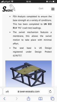

@swerveseats I've seen your posts in a few other threads and haven't seen a reply to the question about being crash tested or having any form safety certificate. Is this something your product has?

@Greybeard That's it. Doesn't look like the clasp is included in the safety testing. I wonder if that could be an issue?
To be completely transparent. The latch is load tested to significantly higher loads than will be placed on it.
The base itself has had analysis, simulations and calculations completed by myself and verified by others (Chartered Mechanical Engineers) and passes with flying colours. These have been conducted to the loads as prescribed by the "M1 test". We will be completing physical load testing in due course.
