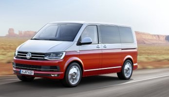

I sense a colour-change on the cards!
Yes! But really don’t know how door shuts etc get done? I’ve always been the mindset colour and doors is one thing you really can’t change and don’t want it look Mickey Mouse!
It depends how much of the red you want to cover up - if you can live with 50% of it, go for a two tone paint job. That way all of your door shuts, interior panelling that’s on show, etc remains red, and doesn’t look odd. Paint either the bottom (my preferred) or the top with a new colour, get the red tidied up, and it will look great.
Otherwise you are right for a full colour change. It is either extremely involved to get it done properly, or a quick blow over which doesn’t sound at all like what you want.
This is based on exactly my thoughts. I had a rough looking silver t5.1 and it is now blue bottom and silver top. I am really happy with it.
I had mine done by Paintworx Loughborough, complete glass out panels, doors everything removed it was quite scary on such a new low mileage van at the time lol message me if you want a rough idea of cost obviously mine was done over 18months ago but I can pass Steve’s details on if you want them . IMG_6746.jpeg
