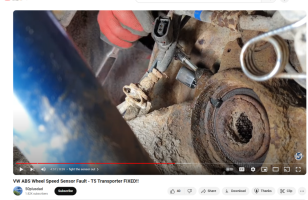

the ABS wire and sensor go direct to the wheel HUB.
the ABS wheel speed sensor is shown here . . .
