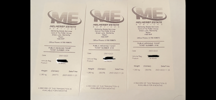

Pics of my ‘empty’ weights below. That is fixed kit, basics I always have onboard, gas bottle, full fuel and adblue but no people, water or optional/variable kit such as clothes, awnings, kayaks etc. Don’t travel with full water, just top up when you get there or close by. Mine is a T28, 150bhp manual with full side kitchen conversion RnR bed, heater, pop top etc.
Edit - use the carrier for light bulky stuff such as bedding, clothes etc and stay within the towbar and rear axle limits.

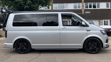

Ours was 2.3ton with full equipped kitchen bedding, chairs gas and lots of stuff we usually carry round. I up-plated when we were 4 of us (2 teenagers), 4 bikes on the rack, luggage for 4, a big awning, a small awning. With about 0.7ton to mess with I reckon we still could be over the new 3ton limit. Now though with 2 of us I think we will always run well under.
I googled the local council to find a weigh bridge and used svtech to up plate. Can go to 3.2 pretty easily too with most wheels/tyres and aftermarket suspension covered
Fully loaded and running a bit low at the back

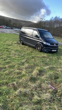

Ps: the pic of my van on the grass only weeks into having it resulted in being towed out by VW assist, felt like a right fool. Lesson learned when he turned up in a T6 and said it was the worst van to pull out ….. too used to having Discovery.. epic fail. He was a conversion enthusiast thankfully.

I’ve just been to weigh in and we are 2.3, there’s only the gas, few plates etc and pop up tent in there at the minute so it’s going to be tight but hopefully ok.
