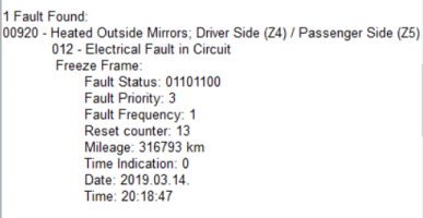

Hello hope someone might be able to help, the heated mirrors have never worked on my van and with the cold weather thought i would try to get them working. I've had a go at fixing it but now I'm a bit stuck with what to try. I've got a 2015 T5.1 it has heated mirrors but there not working on either side. With the vagcom its showing 00920 fault
