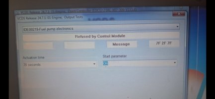

Hex+Can on 2016 mod Transporter 2016 Working?

Upon the first launch of the program, I was able to bleed the fuel system one time.
On 2. try now most of the tests Output Test functions not working, all reporting 'Refused by Control Module' 7F 2F 7F .
should be fine then. . .
so you are trying to run the fuel lift pumps?
have you tried locking the van for 30mins so it sleeps? - then try again.
also try opening/closing the van bonet, as this sometimes can stop functions from running,
Have removed the battery for 24 hours. shorted + - terminal. bonet open and bonet closed. deleted software and try new. Tried with another PC.
but will try to lock the car.
Yes trying to bleed the system.

I have this exact issue with my VCDS, everything else works but no lift pump for priming. Same tablet and interface work fine on T5.1. In the end I just used my OBD11 to prime after a filter change.
