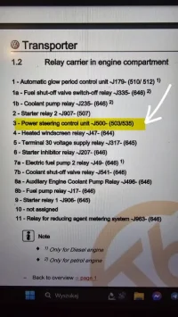

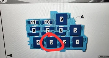

What kind of relay will it be, and where will it be located on the electrical diagram?
What will be the OEM of this part, I think it will be Switch Combination.

Found it:
I'm assuming from the link you have a T6 - and as a VIP Member this should help - relay type is in brackets after the location:
Note though that glancing through the T6 H4 and H7 current flow diagrams I don't see an explicit relay noted, just the J519 on board supply unit
