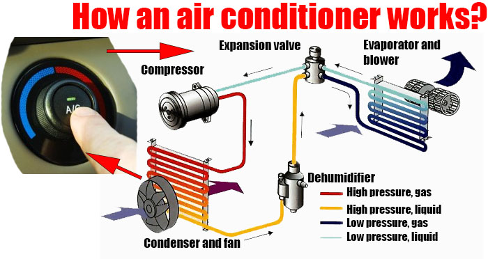

It's perfectly normal. For the A/C to produce cold into cabin it must dissipate the "collected" heat from cabin via condenser (the element that looks like a radiator - in front of engine's radiator). To take the heat away from the condenser running the coolant fan is necessary - especially at standstill.
Better explained e.g. here
