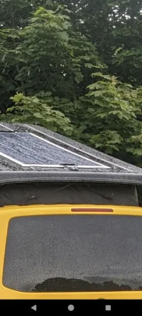

This is our panel, cable is visible as it enters into the roof space (Ie when the roof is up you can see the cable) and then disappears into the van. We had to have the panel replaced last month as it died..
Is that panel set back as far as it can, so that the cable entry is as close to the canvas as it can be?
