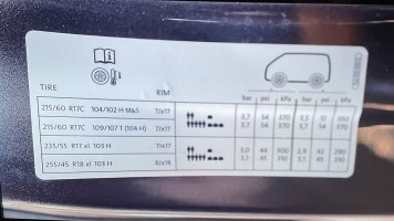

I’m pretty certain you need XL (or C). Have a look on the tyre pressure sticker to see what tyres are required. I’m pretty certain that a C or XL (depending on size) tyre is needed for a T6. Fitting non reinforced tyres could cause issues if you needed to make an insurance claim or had an accident if the manufacturer specifies reinforced tyres. Unless you tell them beforehand of course.
I’ve attached 2 pictures of tyre stickers. One from my T28 PV and another from a California. Both show C and XL tyres.
