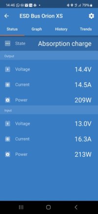

No, still a charge enable,.... Because the smart Alternator voltage varies so much with the start stop setup.
If the voltage is too low from the engine bay you only a small amount of charge in the back..
The power out the charger is dependent on the voltage coming in.
The IGN in signal will basically just tell it to stop charging when the IGN is off..... But charge rate is dependent on the above.
So basically, drive around with the headlights and heater on to charge the leisure battery :laugh:
If your starter battery is fully charged then the smart alternator will only put out 12.6 volts or so.
So basically yes you need to turn on a high load which will make the alternator push up the voltage to say 13.8 volts or 14 or more votes. That's will then enable the dc dc charger to put out a full charge power.

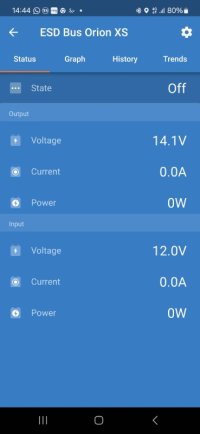

I like using the victron chargers as you can tweak the charge settings and the auto engine detection settings..... So you can set up the voltage levels that the charger will start / stop also match them with the engine auto run detection algorithm.
I've got both my Orion xs50 amp DC chargers set up perfectly now for both vans... And both charger settings are slightly different.
