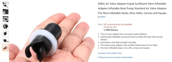

they look similar?
does this one work with Vango stuff ?
Well I've got an exact copy of that inflator, but it's branded Seamax and the valves it came with didn't work on my Vango Galli. I use it to blow up my sup which it does well, but it would pop an Airbeam if you set the psi too high.

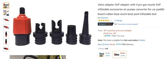

this one somes with a couple of adapters . .
they look similar?
That looks the same as my pump and the connector on the left is the Airspeed fitting. They look similar to sup connectors but they aren't, I snapped mine off trying to force it to fit.
