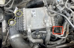

I recently got a 2018 T6 and whilst giving the engine bay a clean I've spotted that the intercooler is missing a bolt and rubber mount. Picture stolen from google and I've highlighted in Red where i'm missing it. Does anyone know the part number for the bolt and rubber mount?

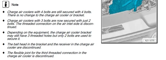

I think there aren't supposted to be a bolt on the down right corner, even though it's illustrated in the parts catalogue that way. Catalog also tells the amount of used parts in current photo and there's supposed to be 2 bolts, with accessories in total. My fathers MY2019 T6 also has the chargecooler attached only with two bolts as yours.
Apologies for jumping in on this post, but I have the same ‘issue’. Fixing appears to be missing and the thing rattles about a bit when the engine is running. Can anyone confirm definitively if there should be a bolt attached here or not? To me when I look into the hole below it, it doesn’t even seem like it is tapped for a thread???
