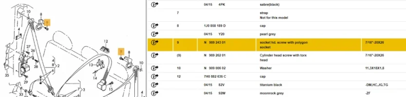

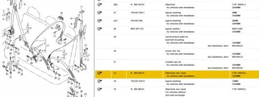

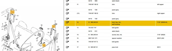

Think they are seatbelt fixings if you have a third row of seats
Let me consult etka and see if it lists bolt sizes dimensions
Great thanks, should have thought of that and measured the 2nd row! :whistle: Right off to find some imperial bolts!
