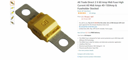

60A could be a MIDI fuse?
Brilliant! Cheers dellmassive. Does 60amp sound about right as im only going off what is in the other inline fuse for the smart charger?

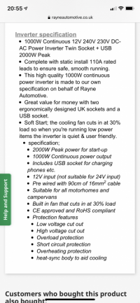

The cable is too short, it can be passed thru the back of panels when i finally fit it and into the kitchen cupboard hopefully
That says it needs 110A for installed... Max power.
Are you just using the supplied leads and fuse?
Over 40A is BIG power and needs careful installation and care that the cable is correctly rated and correctly fused.
Post a few pics of the install.
The cable etc came with the inverter and was from rayne automotive as was the whole setup so i am happy its up to the job. I can get the same cable with ring connectors from halfords however i dont know what to use to connect the ring connectors together and then maybe use the heat shrink plastic covers to seal or whether there is a more substantial connector i can use instead. Obvs i want it to be safe but at the moment the inverter wont reach to the back cupboard so wish to extend so itll reach to there.
If you pull 1000w out of that at mains voltage you are looking at around 85-90 amps @ 12 volts
