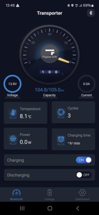

Nothing it was something like 0.3v at the fuse,trip with a multi meter, it's almost like the battery has a safety cut off or something?
Yes! - The battery has a safety cut off.
The Fogstar 105Ah battery has overcurrent protection and the maximum discharge current is 100A- So the battery BMS will probably cut the output if you try exceeding this.
The Renogy doesn't seem to spec its maximum in-rush current - just seems to say fit 150A fuse on the 12V wiring. - But why it used to work and doesn't now? don't know, but could be temperature related - even at 8C

Thanks for that Simon, could be temperature related i suppose, lets hope that is the probem.
