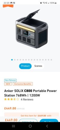

So just a recap.
C800 no camp lights.
C800 Plus - with camp lights.
Was wondering about the physical size of the c800 Vs the ecoflow D2
I was originally looking at the c1000 Vs D2. But went for Anker as their customer service has been brilliant and not read great things about Ecoflow's customer service. Then I realised it was £300 more than the C800 for not loads more capacity. Loved the idea of the torches as both have different functions and recharge automatically in the lid.
