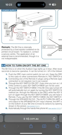

Just to clarify what I meant:
Yours may well be set up differently. Mine is powered by the leisure battery but is set to only power up when ignition is at first stage i.e. no crank.
There are two ways from memory to get the unit to power up when ignition is on (IGN+) - one was by connecting to the IGN+ of the vehicle’s power system, the other was by using the remote signal from the head unit.
Think that’s cable 3 on this diagram.
Might be worth seeing if you get 12v on that cable when ignition is on.
