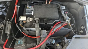

I've had issues (and am still having) with battery drain on my 2021 T6.1 Transporter. I was trying to work out if there was a drain from the tracker & alarm but I also suspect the battery might just be dead and need replacing. I'm after some sage advice from the forum to help!!
I'm sharing the voltage charge that the Starline alarm system provides. Since I've had it, the battery only last 2/3 days before needing starting-up. I've resorted to plugging the thing into my mains and charging the starter via my EC155 power supply unit.
Also, my theory was the alarm/tracker draining the starter given how many wires are connected to the positive terminal; is this normal or is the wiring setup not right?
