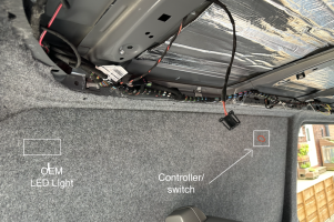

OK, Im thinking about fitting some extra LED lighting in the van, and a controller / dimmer switch and maybe a couple of USB charge points into the panels between the C and D pillar.
However I am struggling to find a route for the witing from the area where the OEM loom is near the roof of the van down behind the panels.
Am I missing the obvious? Is there one? If there is where is it?
Thanks in advance.

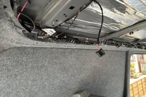

This void here travels all the way down the D pillar into the rear quarter
