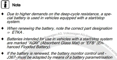

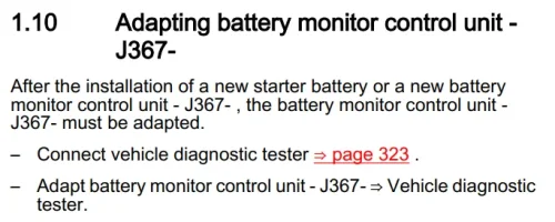

Here is a few clips from the 2019 Service Manual:
So the official VW word is that the module needs coding, as
@Pauly said above, to enter the new battery metrics and clear the old logs.
its assumed that the new battery would be be 100% SOC/SOH as its new,
but i think the observed "
self learning state for around 10 start cycles after the battery has been disconnected" is the way that the Energy management system ensures that the battery is 100% SOC before thew stop/start kicks in and the battery monitor resets it self.
fitting a new battery without coding may cause the EMS (energy management system) to assume that the battery still has a low SOH and poor ability to hold a charge and may adapt the battery charging strategy. This may intern end up effecting the new battery as it me not be charged up properly......
