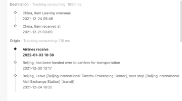

Now I'm getting excited. I've had a full refund but will it be a packet of seeds, a ball bearing or a 1500w Jackery solar generator with 4 panels. But this does conflict with the Shanghai tracking they sent.
Edit: Plus I do now have the Royal Mail tracking and confirmation of leaving China!
And its still coming (allegedly). Its now with the airline. Royal Mail confirm the parcel is on it's way!
