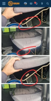

The ovano is a great system I’m a carpenter and had one of these great for tools in the week and the odd wkend away but even tho it doesn’t need the seat in to be a bed it does still use that space where the bench would be when in bed position if that makes sense
Yep that’s just what I needed to hear.
Have you looked at the @VAN-KING system? I have a lwb Shuttle which I use for carrying bikes and occasional sleeping/camping. Middle row seats are left in, or one removed for the fridge (which is too tall to fit under the bed :oops:), Bed boards and mattress can be stacked folded, or removed to give full space. The frame is stable without the cross bars if you need the space for work. Murray also has a slide-out platform if you need to be able to access heavy tools, boxes, or a kitchen pod.
