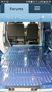

I think you can. The shuttle has the triple bench in the rear to. The mid row seats are singles. The foot print off the triple is the same as the mid row centre single seat. The centre single also has its seatbelt integrated into the seat itself. However the mid row single side seats have a narrower footprint and also need the side pillar mounted seat belts, so they wont work. Have a look at the picture. The dimples on the floor are the locations where the floor brackets fit. Note the centre locating points are wider than those at the sides. So in short, you need a Shuttle mid row single seat (must be the centre seat) to achieve what your after. Not the single seat from a kombi.

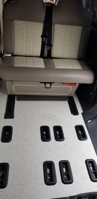

Just realised I still have this photo also. Clearly shows the different footprint widths.
Thanks for supplying the photos, I guess thinking about it now the fittings on the triple would need to be wider to stop it potentially leaning to one side ? I hardly use the triple seat now and would rather lose the seating and gain the space for maybe a kitchen pod.

Here is the single shuttle seat I have for sale clipped into the brackets for the bench seat in the back of my SWB (row 3)
The only alteration you would have to make for row 2 seating (immediately behind the driver) is with 2 & 1 Kombi seats where you would need an extra 2 floor brackets installing.
