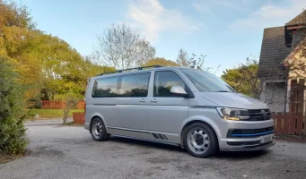

Does anyone know the load rating of the Land Rover Defender 18” steel wheels, LR143917. Some photos attached found on this board.
I’ve got a T32 LWB Kombi due to arrive approx. end of March and am trying to decide what customising to do.
For the wheels, it’s either these or the 18” Amorak steels for me at the moment.
Thanks everyone.
Tom

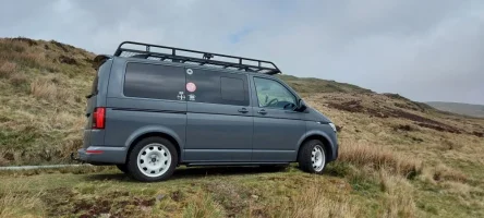

I've had Amaroks and are now running LR (my Pure Grey van in the original post). The LR wheels are far far heavier built than the Amaroks. No idea of the actual rating and difficulty finding it on Google...perhaps a LR forum could answer ??
