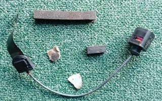

There wern't any leaves of mulch in the cavity, but what was in there was a bit bewildering at first, as the pic below might show. Having returned to the forum I searched for heated windscreen problems, and the search bought up a post from a forumite saying that whilst cleaning the scuttle on his van, he'd dislodged one of contacts to the screen, and wanted to know if he could re-attach it himself, or need proffesional help.
One of the answers to his query mentioned that sometimes when a fitter replaces a windscreen, the old cable and bits are left in the pan. As I have two wires etc still connected to my screen on the nearsidem and two offsise, I can only surmise that something similar happened to my van in a previous ownership..... either a new screen, or a new cable attached.
All very strange indeed, and I'm hoping it was the crud that was blocking the drain hole, and in heavy and persistant rain the level was reaching a grommet in the bulkhead that cables pass through.
