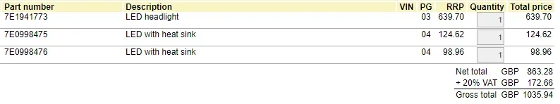

Thankfully not so crazy priced for a T6, the LEDs are available as independent parts
Here the retail net cost of complete headlamp followed by both headlight LED elements
Never looked at a headlight in terms of taking it apart but from the above image it looks like a few screws and you can remove the LED insert/module (but i doubt it will be that easy !)
