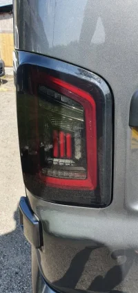

I have Led rear lamps and on one side n/s the brake light part has stopped working .

Can you post a picture of your lights?

I'll attach a photo .
The lamps are after market and your right that they are completely sealed.

Update .....
I had a chat with an auto electrician who told me it would be very unlikely that the led strip would stop working and have a look at the connections behind .
Took the lamp off , gave the wires a wiggle and boom the brakes came on !
