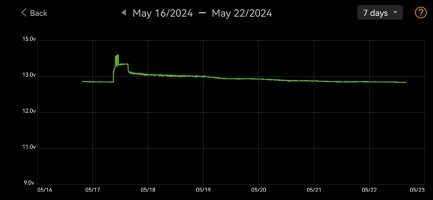

When you have 7 days worth of data post a screenshot of the bm2 plot.
Of the voltage doesn't show a constant drop over time you are good.

Hi, thanks for your response. Both batteries are wired up in parallel, so as one big battery of 240ah, both were bought brand-new just over a week ago. I'm losing 3 to 4% daily. I've attached my BM2 plot. When I was in the van with everything switched off the only thing running was PLC screen. The screen was showing a constant draw on the battery of 0.7amps.

0.7A x 24 hours will be consuming 0.7 x 24 = 16.8 Ah a day which is about 7%
