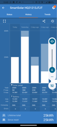

Screenshot attached showing the low voltage for the two days we were away.

Battery reaching the end of it's life sounds the most likely, leisure batteries have a hard life.
It's normal for the battery voltage to settle back a little bit after charging finishes, and likewise normal for the voltage to drop under load. But by the sounds of it you know what's "normal" for your van and this is starting to change?
11.5v is a concern if that's the resting voltage as that will be below 50% charge, but under load isn't an immediate concern.
If you get the battery fully charged ideally disconnect it and let is rest for 30 minutes or so, then regularly check the voltage with a multimeter which should confirm if it's fundamentally holding charge.

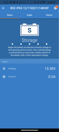

Update on charging: before charging, leisure battery showing 13v with no load. Switched on heater and voltage dropped to 11.8 v after 2-3 minutes.
Connected mains hook up, voltage at 14.2 and charger showing 1A.
After 8 hours charger down to 0.2A and showing full charge!
Looking like the battery isn't holding any charge. So a bad state of health.
Fyi... The orange cog is telling you there is a firmware update for the charger.
The red flag for me is that short charge cycle of about 10Ah, even if the battery is holding the charge it has it's lost a very large amount of capacity so I suspect the plates and electrolyte are knackered.
